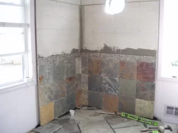

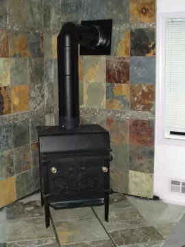

i passed the rough ("building & fire) set the base and wall slate need more base slates tho. ck out the pics and thanks for all your help.

I like the slate it looks really nice. We redid one of the hearths in our showroom with slate this year. Did you paint the stove or use stoveblack?
this stove sat in my sisters basement rusty and dusty for a bunch of years (maybe 3-5) she never used it and i really don't think it was used much at all . the lines are straight and the bricks are realitively clean. i wire wheeled it and brushed some ospho on it . let it sit for 24-48 hrs and washed it down with mineral spirits then let it dry and sprayed it flat black(heat paint of course). i was happy with the out come.

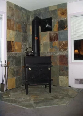

Man, I can't express how much I like that stone!!
Oh, btw, next time you take a picture with the stove burning, please do it with the doors open for the sake of the pyros on the board (ME!)
:-p
it's really hard to take a pic of the stove burning when you have a beer in one hand and a smile on your face so big it hurts,lol. next time i get home you got it . i got the wall slate from home depot and the base from a local landscape guy. thanks it makes me prouder,lol. i still have to finish the sides and grout the floor and wall but to get it done in a weekend i'm "burned" out pardon the pun. and lemme tell ya putting up the chimney in the drizzling rain kinda sucked but time was not an option. i hate ladders no probs with height , just reached a little to far once from 30' up and landed on my back. god ....that last inch was bummer. thanks again

That's some job with the slate on the walls - kudos to you. We did the slate on
just the base for our unit and I know how tough that is. Beautiful job.
