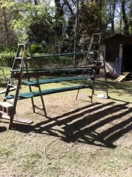

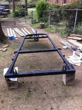

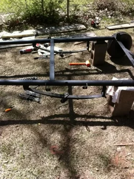

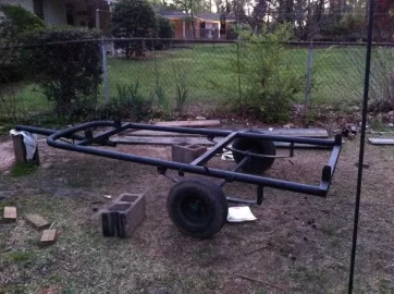

Just finished the last coat on the frame and the wheels. As soon as I get the bushing issue figured out ill be on to re-assembly:cool:

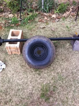

Got the leaf springs bolted in today and the wheels bolted to the axle. Tomorrow ill bolt the axle up and put the fenders on and then its on to the woodwork!

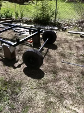

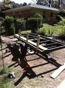

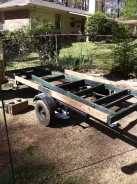

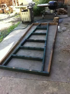

Well the trailer is on it's own weight again. Got the axle back under it and also painted the wooden frame in hunter green. Tomorrow the fenders will go on as well as the wooden frame and ill cut a new 2x4 to square up the front

might be an idea to run your trailer wires now through the frame , or make sure the wire has plenty of holding points for it before you cover up the deck , but starting to look good .

That would be a good idea I just don't have my brake lights yet haha. I got the wooden frame bolted in and squared up. I'm measuring for the decking now. It's starting to look like a trialer again!

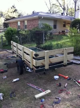

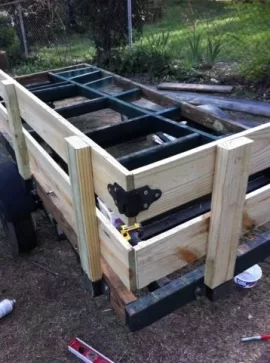

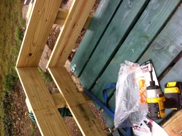

Got a lot done today. After the frame was bolted in I got all my 5/4X6s measured out and painted. I got all the stakeside pockets screwed in as well. The left side and tailgate are done and are easily removed using the corner connectors:cool:
Some pics from todays work:
[Hearth.com] My trailer rebuild thread[Hearth.com] My trailer rebuild thread[Hearth.com] My trailer rebuild thread[Hearth.com] My trailer rebuild thread[Hearth.com] My trailer rebuild thread[Hearth.com] My trailer rebuild thread[Hearth.com] My trailer rebuild thread
The sides come up 17 inches

Nice job on the sides & squaring it up.

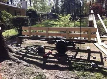

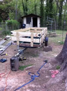

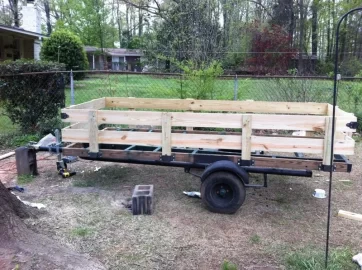

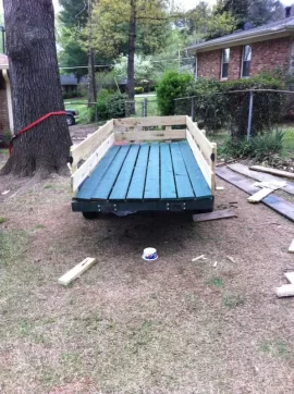

Almost done! Finished putting in all the sides this morning. All are removable except for the front. Decking is layed out and just needs to be screwed down

Got it loaded with wood today? :)

Looking good. Just be careful of those tall sides. Like I said, 9" tall load of oak in there and you will be at capacity. If you load it to the top of those 17" sides with green oak you will certainly break it.

Yeah I'll be mindful not to fill it all the way with wood, it'll be used for hauling scrap as well so the taller sides will be handy for that, along with any other miscellaneous yard trash/crap that needs hauled.

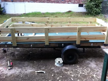

It survived its maiden voyage! Granted it was just carrying a mower a blower and some gas but it didn't explode so it was a good trip haha. All that's left is some little things to button up: trim the rear edge of the decking so the tailgate will fit on, add d-rings, and paint

A few little updates from today...

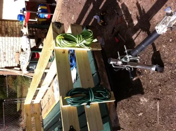

Since this trailer will be used for my handyman/landscaping jobs as well as firewood gathering I added some touches to make it better suited for that duty

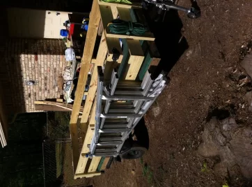

Ladder rack on the side: bungees down and locks to the stake side with bike cable
Extension cord hooks:

Looking good, but do the extension cords just sit on one hook each? If so I'd be worried about hitting a bump and losing them.
They do. I considered that as well but it's a tight fit to get them on and the hook curves back over the top of the cord if you get what I mean. The cord slides into the hook moreso than it just rests on it. I may take it down my road over the speed bumps to see if I can knock them off but I think they're on tight enough that they'll stay
Yeah, I agree on the testing over some speed bumps. Just do it when there isn't much traffic :-)
