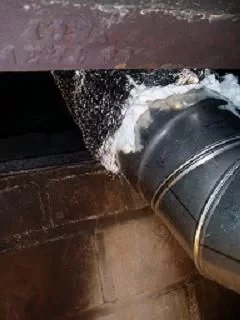

cleaned/scrubbed chimney
316ti flex flue and 1/2" insluate wrap both via Chimney liner Depot
love the cap, just didt take a pic.
26 gauge sheet block off plate and hi-temp silicone
hearth is 2 sheets 28 gauge sheet
1 sheet 1/2 durock w/ a second pc of 1/2" durock directly under stove
versabond, some grout, and some slate from outside. (notice the heart I made.. that got me some!)
18 inches from stove front to hearth front
ok so i got carried away with the insulation and tape, but i'm obsessive at times

also to add, from the elbow i used 6 inches of the black stove pipe.
(the elbow is the slightest bit golden now, thats normal right?)
I screwed it to the stove collar, and wrapped it with my favorite aluminum tape.
the stove sits from the collar forward from the fireplace.
the only only only thing i screwed up, was the cap.
without thinking I used the like the black furnace mortar to adhere it to the clay.
afterwhich i read that you need to fire at 1500 degrees to cure.
well, its hard as a rock, but i have a feeling i have to silicone it next year.

Looks real nice. Aluminum tape? Is that rated temp wise? The pinging noise is normal.

its the self stick aluminum foil type tape that came with the insulation kit. to do the seem. feels like aluminum foil.
my chimney is only 15 ft so i had leftover.
i was wondering how it would fare and so far after a few 600 degree runs it hasnt come undone anywhere i used it.
