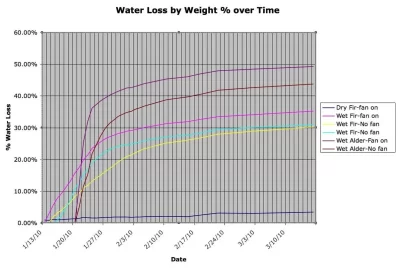

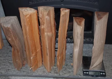

Last February I started this wood drying experiment. Not a well thought out, controlled, designed ahead of time experiment, but the kind you think of as you pass by some really wet wood and think "what if..." adjust as you go. Something just right for the esteemed peer reviewed journal of "The Wood Shed". It was February in NW Oregon, had been raining for a few months and as luck would turn out, it would rain through June. I had what I thought was and turned out to be a very well seasoned split of fir along with two fresh blow downs, both about 24" DBH, one of fir and one alder. I started with a split of that wet fir and set it up along side my seasoned piece of fir about 6' in front of a small desk fan out in my garage. The next day I added 2 splits (1 normal, 1 thin) from the same round of fir but placed them about 12' off to the side out of the path of the fan. A few days later I added a split of the very wet Alder, one in front of the fan and one off to the side. The garage is unheated and hangs around 5-15 degrees above outside temps during winter. More when it's colder, less when it's warmer. About 50 °F inside when its 40°F outside. See average weather on table.
Mind you these splits were very wet and in the Alder's case turned out to be over 100% moisture content. ((Starting wt. - oven dry wt.) / oven dry wt.) I tried to weigh them every day for the next 3 weeks and less regularly for the following month. After 2 months I turned the fan off and when summer finally came in July, I put all the splits out on the asphalt in the open sun and wind where they could dry some more. I brought them back in the garage in September and weighed them in November and again in Dec and then baked them dry so I could calculate their actual moisture content during the entire drying process.
I misplaced some weight data before and after I moved them from the garage to the asphalt this summer. Sorry about that, I'm still looking for that sheet, but I think I still learned a bunch that applies to storing and seasoning wood.
Here are my thoughts:
A bit of air movement will lower the moisture content of wet wood very quickly when combined with a slight increase in air temperature over ambient. While I originally thought air movement was the key factor, (and clearly it's important-9 months later you can still see the advantage the splits in front of the fan have over those away) (SEE Table) I think the slightly higher temperatures in the garage providing a lower relative humidity, thus lowering the Equilibrium Moisture Content (EMC) may as significant in the cause of their relatively quick dry times. I say this because the speed of drying is driven by the gradient difference between the wood moisture content and EMC conditions, assuming there is enough airflow around the wood to evaporate any moisture drawn out. Also, my wood with a fan in an open sided barn where temps are the same as outside don't dry out nearly as fast. Just having a little air movement in the garage was enough for the splits away from the fan to go from unburnable to the burnable range in a month (67%-->23% Fir & 107%-->21% Alder).

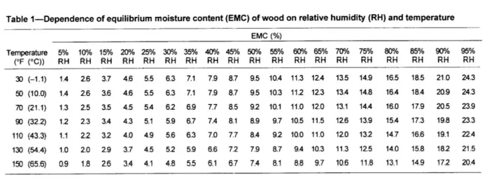

I found the attached tables helpful from here:
(broken link removed)
and this EMC calculator based on Temperature and Humidity
http://www.csgnetwork.com/emctablecalc.html
The document shows that most of us in the country would be OK to burn wood at our average EMC conditions in our area no matter the time of year. Also, the EMC really doesn't vary that much throughout the year exceptions being the arid west and the my area of the NW in particular. It's interesting to see "in general" much of the wood burning NE and upper midwest has the lowest EMC around April.
Since most of us plan on drying our wood for longer than 8 weeks, I am thinking just a bit of air movement combined with warmer temperatures to drive down EMC is a better plan of attack at least during the pacific NW winters than just a covered open sided shed. I calculated my EMC to change from ambient conditions of 18.4 to 12.2 in my garage. How you create the airflow in a closed shed that gives you higher temps seems to be key here.
I could clearly see the effects of wet rainy humid periods increasing the moisture content of my control split (seasoned fir) and slowing the other splits drying. Interesting to also see that all the pieces during the last 2 weeks (a very rainy period) gained moisture as they were pretty dry by this time.

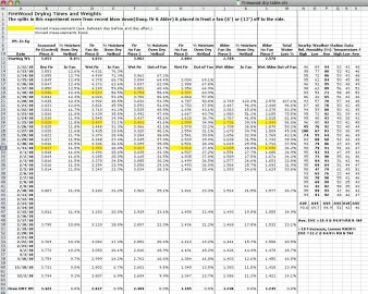

It's really easy to weigh splits for few days in a row with a fan on them and graph their trend in drying knowing that it will slow over time as you get closer to the EMC conditions.
The studies say that moisture moves out the ends of a split 10-15 times faster than out the sides. When performing the final dry in the oven, you could really see the remaining moisture coming out ends of the splits verses sides by placing a small glass over the end. I also feel the longer splits ~22" were at a definite disadvantage for drying than splits in the 16-18" range.
Everybody should take at least one split of wood they are currently burning, weigh it, then oven dry it (use convection setting if you have it) 275 F for about 6 hours worked for me, but it was pretty dry to start with. Weigh it and repeat until it stops loosing weight so you "really" know what the moisture content is. If your curiosity isn't enough to get you to do this, do it for the fun of seeing your stove operate with a bone dry piece of wood especially with the draft closed! I could really tell the difference in my secondary burn verses wood with 16% moisture.
Conclusion: Ultimately, I think a green house type of wood shed with some air convective system will dry my wood out faster than than an open sided one, partly because of our long wet winters but mostly because of all the additional hours seasoning with a lower EMC because of warmer temperatures every night and thus lower RH's.

  • [Hearth.com] My Wood Drying Experiment

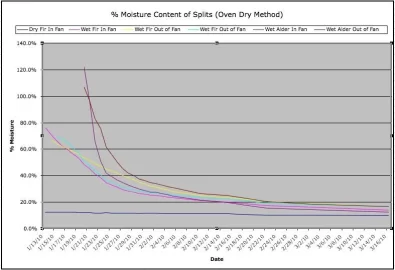

I finally got my moisture graph to plot. I figured going from 122% moisture to 12% in less than two months would have gotten a few more comments.
