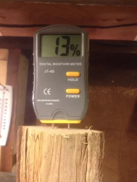

3 year old white oak on the moisture meter. In this years wood shed stash is white oak, red oak, sycamore, white ash, and some misc. cherry, etc. all 3 years old. SWEET:)! I don't put too much credence in moisture meters but it doesn't exactly contradict Dennis' 3 year theory either. lol

Nice Steve. It might measure a little higher in a fresh split, but you still have some nice seasoned wood there.:)
I'm sure after 3 years it's perfectly burnable wood, but you do know that you are suppose to re-split it and take the reading on the freshly split face. Right?
Poking the pins in the dry ends like that doesn't give you an accurate reading of the wood inside.

I was wondering when you guys would mention that. Actually, I chopped a split that was too long in half with my chop saw. So the meter is stuck as close to the middle as you can get. There is a little difference some times between "with the grain" and "accross the grain", but like I said, I like the "Dennis Method" the best anyway.;) I just like to mess with gadjets and curious to see if the meter says the same thing the wood says when it burns.......dryyyyyy.

I don't think I've ever bothered to compare 2-3 year old wood by checking the end, then splitting and checking the fresh face.
Curious now.
Come on Steve, you know you want to. ;lol
I did recently resplit a piece of Oak and the fresh split face was 16%, so I'm happy with that.
The year old soft Maple still has a tiny amount of water in some splits, but not enough to make a real difference. Burns well, but I haven't checked the MC yet.

Dave, I have done that before and all I remember is that there was a difference, but I don't remember how much. I will try it and see.
I There is a little difference some times between "with the grain" and "accross the grain", I just like to mess with gadjets and curious to see if the meter says the same thing the wood says when it burns.......dryyyyyy.
I've never noticed any difference between checking with the grain or across the grain, but I have found huge differences between measuring the dry exterior of the wood and splitting (or cutting) open the wood and taking a moisture reading inside.
