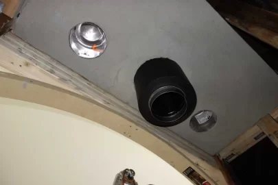

Getting busy with my project. Already got the initial electrical and mechanical and construction permits done. Getting the installation permit hopefully done this week. Using icc excell chimney. [Hearth.com] My zero clearance to alcove installation [Hearth.com] My zero clearance to alcove installation [Hearth.com] My zero clearance to alcove installation [Hearth.com] My zero clearance to alcove installation Gonna install a blaze king ashford 30.

Wow thanks dieselhead. Looks great. Couple of questions. How did manage too meet the minimum 6" requirements for the back wall. I am still debating about whether to wrap the stone around the front edge with maybe 4" of stone on the front or doing the stone all on the inside like you. Any insights or suggestions. Also those are beautiful stones. What are they. Did they come in sheets or did you cut and place them yourself. I see the sheets are like $25sq/ft. I can not afford those for mine. How much did you spend for those stones. Again looks fabulous.
I used this stone:
http://www.homedepot.com/p/MS-Inter...ll-Tile-4-sq-ft-case-LPNLSCALGLD624/202902386
I met the 6" no problem. I thought about wrapping the stone too but think the design I went with looks a lot cleaner.
