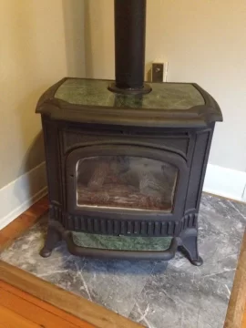

This beautiful propane stove is missing the info tag. Any ideas on the make and model or where I could find a new pilot assembly? I love it and want to get it working again.

Can you open the door, carefully remove the log set
(take a pic of each log in position BEFORE you remove it!)
& take a picture of the pilot assembly that is in there now?
Can you also take a picture of the gas valve?

Thank you for the reply. I have learned that it is an Earth Stove gas TG440. The pilot assembly was removed to find a replacement last year and then lost. I need to find a replacement (PART #18048?)

Hello. Dated post here, but I have run into the exact same thing. The local company is telling me that the part #18048 is not actually the right part for my stove. It's a 1993, and it "pre electronic ignition". Did that part work for you, or what did you end up using? Thank you.
Take a pic of the pilot assembly, like I instructed you. An identical assembly may be used in another manufacturer’s unit. Without a pic we can’t match it.
