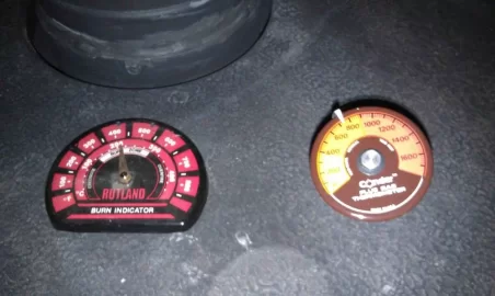

I drilled a 1/4 inch hole in my trivet and use a probe flue gas thermometer to get stove top temps then the magnetic for trivet top temp. I range from 600 - 700, occasional peak at 800.
