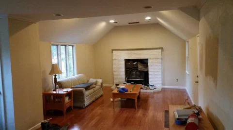

Maybe it's a heatform fireplace actually? Could you please post a picture to make sure an insert can be installed there?
Newbie picture posting problem... Will try from my home computer.
Sorry, I am describing it poorly. I have an older woodstove set inside a hearth that may have been a fireplace at one time.
This is not my house, stove, or pumpkins, but I have a similar setup.
(broken image removed)
There is a 8" steel pipe that connects to the top of my stove and runs continuously and straight up through my masonry/terracotta lined chimney and exits at the top with a chimney cap.
We'll need a shot of the actual fireplace to understand what the unit is being installed in. Do you know if this fireplace has a metal or a masonry chimney (clay tiles) above the fireplace?
[Hearth.com] Napoleon 1402 vs Non-Airtight [Hearth.com] Napoleon 1402 vs Non-Airtight Are you asking about my current setup?
There is a 8" steel pipe that connects to the top of my stove and runs straight up through a metal plate and the pipe continues up through my masonry/terracotta lined chimney and exits at the top with a chimney cap. So... brick exterior, original clay square terracotta, sleeved with 8" pipe.
Figured out how to load my picture. Let me know if you want other angles. This is my stove and hearth, but I now have a vaulted ceiling.
The black pipe exiting the top of the stove continues straight up through my exterior brick chimney. No bends, kinks, or breaks in the pipe.
There is a piece of metal plate on the top inside of the recessed portion with an 8" hole that the black stove pipe passes through before enteringand continuing through the masonry portion of the chimney.
That looks like a straightforward installation. The metal flue liner must be stainless steel, not regular steel smoke pipe.
