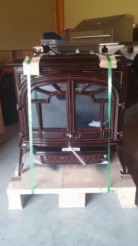

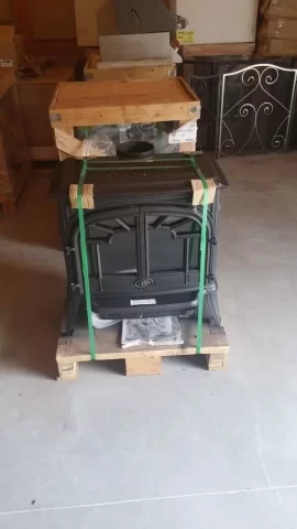

Ok, Thanks , that makes sense, not gonna matter much either way then if the top surface doesnt get super hot. These are my choices [Hearth.com] Napoleon 1600 C Finish Choiceor this
I like the mahogany finish personally. Besides looking great, enameled finishes are easier to clean and stay looking great for year given modest care.
x2 proc mahogany espec if same price!! Porc enamels normally 400 or so more dollars.

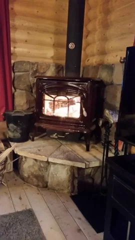

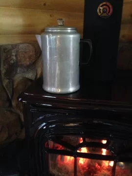

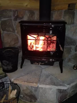

Hello all, I just found this forum. Anyway, I have had the Napoleon 1100C for 10 yrs in a mountain cabin and have the porcelain brown finish. I love it and swear it looks as good now as it did 10 yrs ago. I always put pot of water on it for some added moisture in the air or a coffee pot to keep it warm and never once has it damaged the finish.

As far as maintaining the finish all I ever do is wipe it down once it's cool, that's it.
