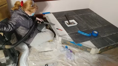

A few days ago we got everything installed and working properly with my new Castleton 8031 TruHybrid wood stove (has a catalyst)
So far it works great! I am burning mostly smaller pieces of wood, I don't have very much dry cordwood.
I filled the firebox halfway and let it burn overnight, it had a nice bed of coals and was still warm to the touch in the morning.
I think if I got it up to the middle of the Catalyst heat range, raked all the embers to one side of the stove, then filled it with hardwood and turned the air down, it would burn for a very long time. It seems to be very efficient and releases a lot of heat, even from smaller pieces of wood.
So far I haven't had any issues with overdrafting or anything. I put in 2 x 45 Degree elbows in the black stovepipe and made sure the chimney height was correct.
Very nice looking stove.
Feel free to ask questions, or if you want me to take pictures of / measure anything on the stove I can!
Pros:
- Looks awesome! Everyone likes the appearence of the soapstone and stove design. The glass viewing window is also nice and big and clear.
- Nice large area on top to set a kettle or pan on. I don't think we will cook anything on here because it may ruin the nice appearence. Maybe once it gets older :D
- Good draft, catalyst works great.
- Convenient ability to choose between rear or top stove pipe placement
- Large firebox accommodating 18" logs.
- The brown majolica porcelain looks great!
Cons:
- The shipping was a mess. The wooden frame they built around the stove was broken apart when they loaded it onto the truck, and I had to literally reinforce it to be able to have 4 people (2 using lifting straps) barely able to carry the stove into the house. Not acceptable for such an expensive and HEAVY stove!!
The "feet" of the stove are pan head bolts, but mine were stripped / the threads were stripped inside the legs / feet of the stove, most likely due to the high weight of the stove and junky pallet / packaging. So I am unable to screw them in properly, making the whole stove wobbly. I am going to call the store I bought the stove from about this and see what they say...
- Very pricey stove! $3000 MSRP, but you get what you pay for :D
[Hearth.com] Hearthstone - Castleton 8031 TruHybrid[Hearth.com] Hearthstone - Castleton 8031 TruHybrid[Hearth.com] Hearthstone - Castleton 8031 TruHybrid[Hearth.com] Hearthstone - Castleton 8031 TruHybrid[Hearth.com] Hearthstone - Castleton 8031 TruHybrid[Hearth.com] Hearthstone - Castleton 8031 TruHybrid[Hearth.com] Hearthstone - Castleton 8031 TruHybrid[Hearth.com] Hearthstone - Castleton 8031 TruHybrid[Hearth.com] Hearthstone - Castleton 8031 TruHybrid[Hearth.com] Hearthstone - Castleton 8031 TruHybrid[Hearth.com] Hearthstone - Castleton 8031 TruHybrid[Hearth.com] Hearthstone - Castleton 8031 TruHybrid[Hearth.com] Hearthstone - Castleton 8031 TruHybrid

You're stove and install looks great! However, I would have never taken that delivery. No way. I would have sent it back telling them what you described and why I had sent it back. A wobbly stove is unacceptable.

How did you meet the 8" and 20 "clearance to combustible requirement at the wall for a corner install? My understanding is you can't call it noncombustible just by installing tile and cement board on a combustible surface.
Maybe the picture just throws me off.

Thanks! Yes it does meet those requirements, the center of the stovepipe as shown in figure "F" is over 20.5" away from the drywall. Same with the corner clearence.
I made those measurements before I put up any tile or built the hearth, at the start of the below video when the blue tape is on the floor, it is meeting the requirements.
That's a nice installation and a helpful video. There is one safety error in the chimney install. Offsets are designed for interior (attic) use, not exterior. At least one Elbow Strap (SDP-ES) is required for each offset. Elbow Straps ensure adequate support
