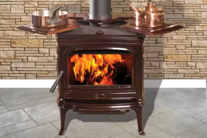

I'm new to the forum and there's a tremendous amount of great information here, but I am hoping for some help in narrowing down what seem to be some viable options. Our house is in the foothills of the Rockies at about 3,500 ft elevation, and we have an old stove we want to replace (it came with the house so I'm not sure what brand it is). The stove is on the bottom floor, but the house has a good design that allows heat to rise to the floor above. The area we're looking to heat is about 2,000 sq ft, and the chimney is just about 30 feet total from the stove to the top outlet. The wood we burn is a mix of fir, larch, and birch, all seasoned for more than two years. In the coldest months (late October - March), we run the stove non-stop. With that said, I'm looking for a stove that's on the larger side, and some that I think might fit the bill are the Woodstock Progress Hybrid, Pacific Energy Alderlea T6, Hearthstone Mansfield or Manchester. I've had cast iron and steel stoves, but never a soapstone stove. A longer burn time and relatively easy operation is important so my wife and kids can manage it well as I'm often gone for extended periods for work. And none of the stoves I've owned have had catalysts (I did have an insert with a catalyst, but it was quite old and not particularly impressive). Any recommendations or advice would be very much welcomed and appreciated!

You will get some good feedback here on your choices and other alternatives. Of the ones you listed, I would say the Pacific Energy Alderlea T6 and Woodstock Progress Hybrid would be the best two. One thing for you is shipping of the Woodstock will add cost as you likely know they sell to customers (note I am getting a Progress Hybrid this summer). I like soapstone, a lot and have had a number of other stoves as well but I like the look and the radiant heat it provides. There will be others on here that don’t like it but that is a personal taste IMHO. Of the two, I think the PE may be a better choice due to shipping costs??? Not sure what they would be for as I am picking up my stove at the factory so saving some dollars. Have you considered a Blaze King like the Ashford? Nice looking and performing stove.

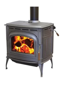

Did a lot of research today and I think the Blaze King Ashford 30 is bubbling to the top of the contenders. Thanks for the recommendation!

The BK is a great stove (I have the Chinook, same firebox and tech, different appearance).
Note though that the long burns (and they are real; I've gotten 37 hrs out of a box of oak before reloading on the coals) are only happening because the heat output in btu's per hour is very low. I.e. don't count on 30 hrs if you need 20,000 BTUs every hour.
The lowest output (when the stove is installed perfectly to specs) is about three and a half 1.5 kW plug in electric heaters. If that's enough to heat your home, great. But in Montana at 3500 ft, that's not happening in winter. Maybe in some shoulder season.
The nice thing is that the BK can go "high" (output) but the technology allows it to go that low in heat output as well.
The "high" seems to be a bit lower than the PE T6 though.
I heat my home (1700 sq ft plus an 825 sq ft insulated basement where the stove sits) with the Chinook, and I rarely go to more than 2 loads a day. (When it's around the freezing mark, I often only have less than 1.5 loads a day). But I live on Long Island, and the "rarely" is a polar vortex event when I reach 5-15 F overnight. Other than that I run on 12 hrs. And that's mostly with oak. Your wood has less btu per volume (it's less dense), so you'll be able to stuff less BTUs into the firebox than if you had oak.
Anyway, I wanted to say that these stoves are great. As I don't know why it bubbled to the top for you, but many people make the mistake that "30 hrs burn time" is equated to "30 hrs heating of 1500 sq ft when it's 15 F outside", and that ain't happening unless you have the best insulated and sealed home there is to have.

Regardless of how much heat you need or get, you can choose to run the BK low enough to burn for the needed time up to the max of 30 or so. Like if you need to be gone for 20 hours one day you can choose to burn the bk at a rate that will get you 20 hours and be still burning and ready to crank up with the twist of a dial. The house may cool some but you will have a fire burning. You have this choice with a BK, not with a noncat.
Or you can run it hot like a noncat and it will burn out sooner. You choose.
Your thermostatic central heat can fill in any gaps.
I burn a princess model BK in Washington. 24 reloads except when it’s in the teens or single digits. Then I throw in a few more splits at the 12 hour point. 1963 built house.

Thanks for all the info. As for wood consumption, are the T6 and BK Ashford 30 relatively comparable under typical heating conditions or could you expect one to use significantly less wood over the course of a year? Meaning, at whatever airflow settings are required to maintain a comfortable heat inside the house (~70-75 degrees) from fall through spring, will the BK use noticeably fewer cords of wood? A lot of variables there I know, but for comparison a long time ago we had a non-cat VC Resolute that went through about 8 cords of mixed cedar and oak a year. I expect both the T6 and the BK would use less than that.

Their efficiencies are close, so for the same heat output they'll use the same fuel quantity - there is no magic involved.
