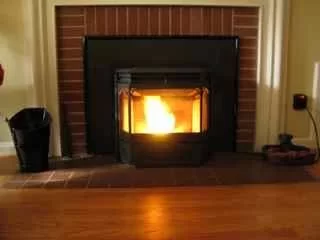

Just installed my Napoleon NPI40 stove and all has gone well. Had it for only a few days but these are my first impressions. Good looking unit and is quite. All seem to be as advertised but the unit does have some drawbacks.
Unit does not put out as much heat as I expected.
Seems to burn a little dirty.
The air adjustment is a little tricky thus I can not seem to find the "sweet spot". Too much air seems to burn cleaner but blows out small flames. Too little air and does not burn clean. Sort of like have a bad carburetor (dating myself here) Why is this adjustment necessary, do other units have this adjustment also? Have not seem much about this in postings.
Lastly, clean up is needed more often and dirtier then expected. FYI only needed a high performance bag ($10) on a low end shopvac mini to do the trick.
Well that's my first impressions so far so good.
