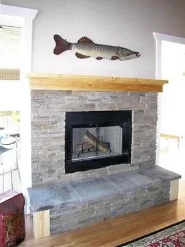

Hi Everyone,
New to the forum here and have had a quick review of some of the threads - seems like this is the right place to be for everthing FP related !
I am looking to replace my current fireplace (Superior BR-36) which is primarily for looks only (installed by previous owner) and wanted to get some opinions on the Napoleon's units. Doubtful I would go with the NZ6000 as I here this unit is a monster and loves to eat wood ... and small children - j/k.
Specifically I am interested in the NZ3000 or NZ26 ZC unit - pro's and con's of each. We have about 2000 sq/ft to heat however it's about 3200 complete with a lower section - not used much for winter. Not sure if the current ZC install would preclude me from going with the 3000 and thus my decision is pretty much made .... any thoughts would be appreciated.
Thanks
