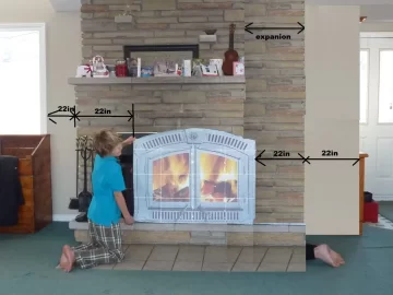

Here's the plan:
- Remove old brick, heatilator and PE insert
- Install new NZ3000 with NZ64 blower (shift FP southwards a few inches)
- Frame and re-surface with vaneer split field stone.

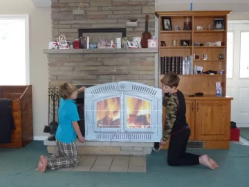

- Below my boys are holding scale size poster of the NZ3000
i [Hearth.com] NZ3000 - Regrets or Concerns? [Hearth.com] NZ3000 - Regrets or Concerns?
My questions is for existing NZ3000 owners. Do you have and regrets or concerns with this product?

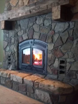

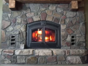

Here's a pic of my fireplace cranking out some heat on a load of elm.......to get you stoked up. That fireplace will look nice in your room. What are you going to face it with, stone or brick?

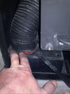

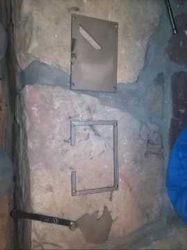

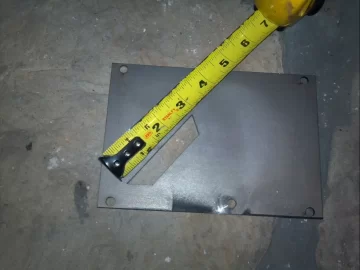

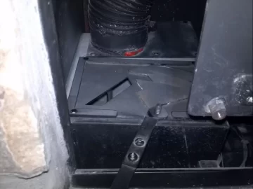

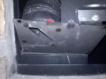

Hey Wisco, thanks for reply. YOU ARE LUCKY AS I HAVE A EASY SOLUTION. I had same problem when closing the doors.......... fire went out like a light. i was getting worried as damper had no affect on the burn, only by leaving the doors slightly open would allow for it to burn.
Well, this was just unacceptable and also a safety hazard. I had a gut feeling something wasn't right so I decided to completely dismantle the stove and find out exactly how it works.
Guess what I found, see pic. What the hell is this? This plate is located between the air-box and 3' hose flange. See how much it restricts the air flow!!! Here's what to do, 1st remove this plate and disgard..... 2nd, look on the bottom of the flange connecting the 3" hose.... it has the same size opening, take a hand grinder and cut-out a square approx 2" by 2" (same size as air-box opening). Reassemble (less that dam plate) and you're done........ now damper works like its suppose too.
I've found that even with this fix, still need to crack door open for 5 - 10 minutes when first starting or re-starting. once roaring, close doors and leave damper wide-open.......... fire dies down slight but soon comes back.
Lastly, my door handel threads we too long and bent when tightly closing the doors. cut approx 1/2" off the ends or until the black spacer becomes snug when screwing the handles back on. [Hearth.com] NZ3000 - Regrets or Concerns?

I noticed that lousy draft slot, too, cobbler. Great pic and description on how to add some draft to the stove. I will be doing this modification on my NZ3000 for sure.
o
Lastly, my door handel threads we too long and bent when tightly closing the doors. cut approx 1/2" off the ends or until the black spacer becomes snug when screwing the handles back on. View attachment 97726

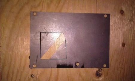

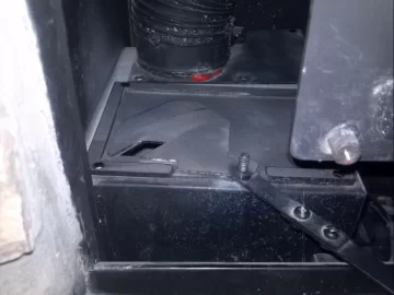

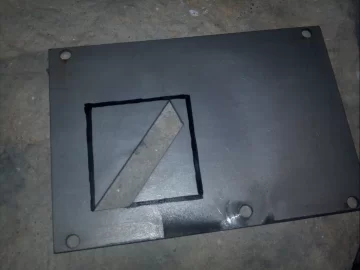

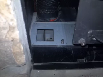

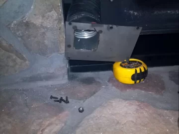

Cobber, I took a little time last night and tore the faceplate off of the NZ. Took the air controller apart and performed the modification....
[Hearth.com] NZ3000 - Regrets or Concerns? [Hearth.com] NZ3000 - Regrets or Concerns? [Hearth.com] NZ3000 - Regrets or Concerns?
I had intended, when I first installed the fireplace, to tear that apart and see what was restricting the airflow. I have no frigging idea why in the hell they have it restricted so badly there!! As you can see from my tape measure, that draft hole is ridiculously small for a firebox the size of the NZ.
I will say that if anyone else performs this modification on their NZ, take your time and do it right. There are TWO spots that are restricted, as seen in the pictures. The part where the 3" air tube outlet is attached take some care and time to cut properly, so as not to ruin the glance where the tube attaches to it.. I used a cutoff wheel on my 4" grinder and also a 1/8" carbide burr bit on the Dremel.....worked like a charm!
[Hearth.com] NZ3000 - Regrets or Concerns? [Hearth.com] NZ3000 - Regrets or Concerns? [Hearth.com] NZ3000 - Regrets or Concerns? [Hearth.com] NZ3000 - Regrets or Concerns?
The difference is literally AMAZING. The fire acts as it should now. The air wash for the glass is noticeably better, and when the doors are shut the fire doesn't get choked out.....
