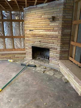

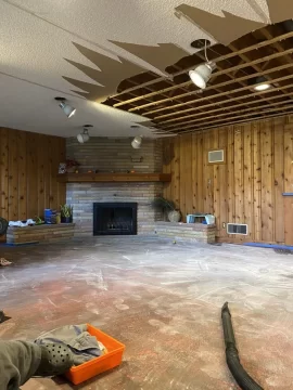

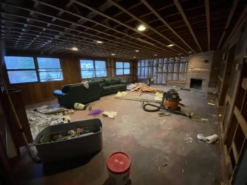

We are doing a complete tear out / remodel of our living room. There is a wood burning masonry fireplace there. We are looking for an insert to give us an extra source of heat, and make our fireplace more efficient. Sat we went to 2 different local shops, and was amazed that 80% of what they had was gas. That said, I like the modern contemporary look and the Napoleon Oakdale EPI3C along with Regency CI2700 seem to fit the look bill. I don’t know much about either. I like the larger viewing glass on the Napoleon, but the Regency takes 22” logs. What’s everyone thoughts on how these are built, warranty, maintenance. Room is 32x22

Looks like you got a big job ahead of you.lol good luck and post some finished pictures

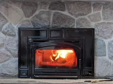

I have the Regency CI2700. Really using it this fall for the first time after getting it late spring. It puts out a ton of heat with the blower only on low. It is quiet also. The cat probe monitor did stop working but I had it replaced through warranty with my dealer. The only thing I don't like is that the corner of the door glass turns black even with dry wood (split 3 years). I've seen other's have the same complaint. I load it up around 7 and have plenty of coals and heat output still when I wake up at 5. The catalyst temp was still in the 350s this morning.
