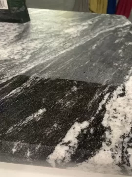

We had a leathered granite counter installed. It has some texture but it’s not a glossy finish. Is just wet the top closest to show the difference. I read that they use diamond tipped brushes to texturize it. Not sure how one could replicate a DIY finish.
Reactions: NHWS
That's a cool granite.
Im not sure how they make that work. Looks like what they call honed granite to me, which is simply stopping at the 1500 grit level I believe.
Edit…. Since the stone is not a uniform hardness it really shows the texture of the stone. Softer material is removed faster than the hard.
