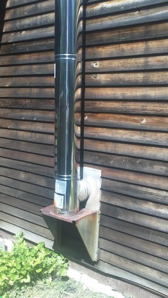

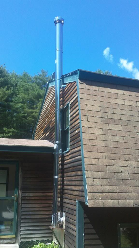

Chimney is 18' outside.

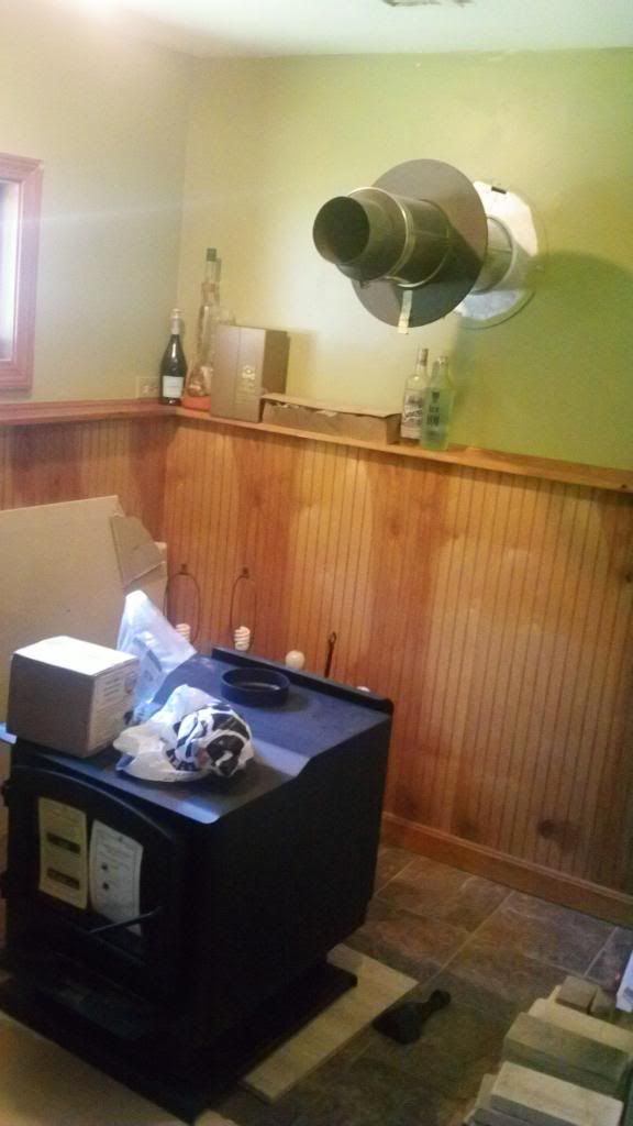

Is the setup as it exists, bought property as a foreclosure late last winter, had the chimney cleaned etc.
Previous owners has heat shields on the walls, But I believe this stove will not require them (I will have to remeasure when it is exactly situated

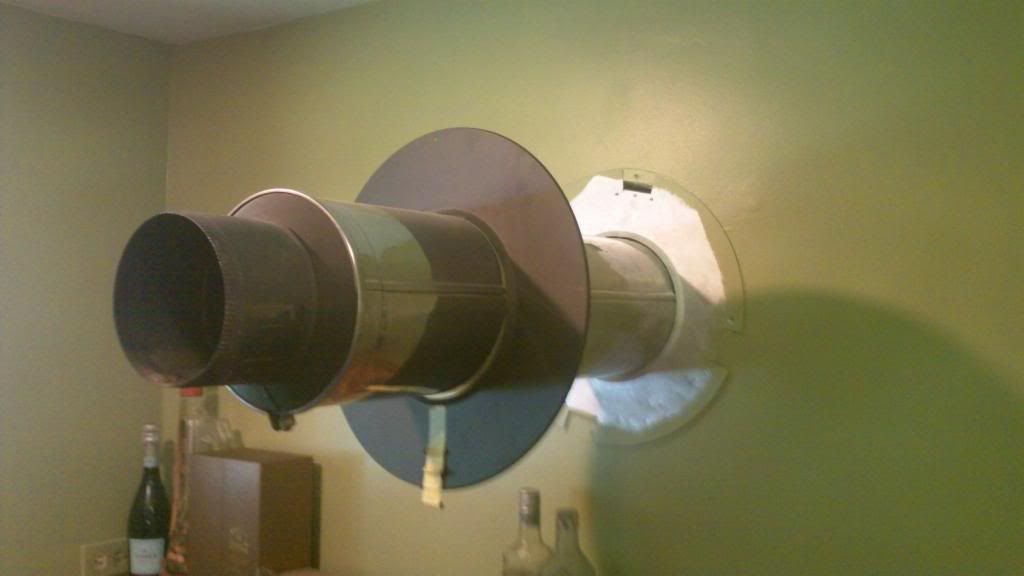

There is too much pipe coming through the thimble. I would pull the horiz. stub coming off the tee and replace it with an 18" or 2 ft (?) shorter piece. The double-wall we are referring to is not double wall chimney. It is double-wall stove (connector) pipe. You may not need it with this setup. If you want to try single-wall it may work out ok. Remember that it needs 18" clearance in all directions from combustibles if unshielded.
Hmm will probably try the single wall then, is 18" clearance really safe or should I use a double 90? and will the double wall interior attach to the double wall chimney without an adapter?

You will probably want to stick with one manufacturer for the entire system. Single and double-wall pieces are usually not interchangeable. You go with one or the other and don't mix pieces. Sometimes there is an adapter needed to connect to the chimney pipe. It depends on the make. What is the mfg and model of the chimney pipe?
