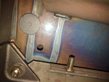

The 30 just has prumary & the secondary air comes from the room. That sounds dumb to me. Why would you bother puting an outside air input on the stove but only feed the primary from it and not the secondary also?
It isn't as bad as it may seem. The inlets for the secondary are two small half inch holes under the front corners of the stove. We aren't talking a lot of air.
[Hearth.com] NC13(ish)
I don't have an OAK on mine, so all air comes from inside the house. It hasn't been a problem. We consistently burn about 3 cords a year here in central Ohio. House is pretty easy to heat. Decent insulation. House is about 2000 sqft. Stove is primary heat. We have some electric radiators in bedrooms so that we can close doors at night, but those rooms remain open any time we aren't sleeping.
