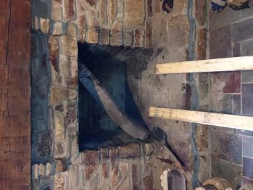

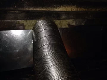

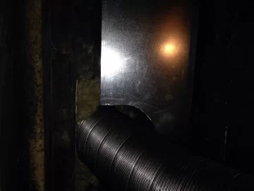

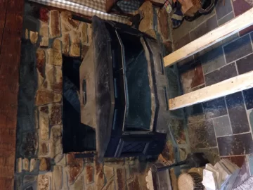

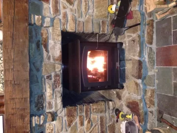

Overall install went smooth except the block off plate. It's alittle rough but gets the job done I suppose. Liner does force the top plate/rain cap up more than I like but it is holding for now. Nc-30 I think looks great ! Doesn't stick out as far as I would like. Also the ac-30 blower is complete garbage only throwing air to the front of the door. Really expected it to launch done air like my old insert did. I hope it keeps up but I wanted the air to be pushed far out because of 25 ft cathedral ceilings. Would have liked the air to reach under my loft into rest of the house. I may call and try a replacement blower . I just can't believe how weak the amount of air is

Call them up and talk to them about what you are experiencing. There might be a problem with the blower as I haven't heard that complaint.
Good looking setup!
Thankyou yea I plan to call em tomm morning. But somehow I ended up with 8" clearance on left side and 6" clearance on the right ha! But I think the looked turned out nice and the fiancé approves . The clearance actually allows me to reach the 4 bolts holding the blower. It will be a pain but I'm pretty sure I can swap out the blower without removing the stove
