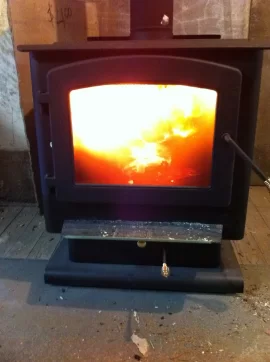

Here is an example of a 30 Making heat.
[/ATTACH]
I'd like to see him put his hand on my 30-NC and then say "No Heat!". Yea, I'd almost pay to see that.
Mine looks like a blast furnace ,had to buy a fan to keep it under 800 Deg stovetop.
