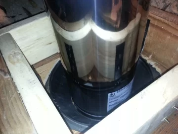

Ok I'm getting there but ran in to a problem with flashing. My roof pitch is 6/12 and my flashing goes to 6/12 so I am pushing the limits which changed my original hole in the roof. I had to move the flashing up which only gives me 1" clearance on the front of the double wall to the flashing in pic 3. Is that safe? In the inside of the house the previous owner put up wood ceiling with panels, I had to tear out some panels but I have the 2" clearance. Is this ok with all that dry pine on the ceiling?
Anybody? Rains on its way, think the flashing clearence is ok?
One inch to the flashing should be ok there as long as the pipe is 2" away from any combustible.
