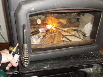

Never have had a top down fire get my draft going in the right direction when it's reversed, just pulls air from the chimney and smokes the house. I have to move a baffle plate (Skamol brick) to access the flue and burn a piece of newspaper first then put the brick back. Don't know if you can do that with the 400.
Bernzomatic propane torch like you would use to solder pipes.
[Hearth.com] Need a better lighter
I would use this^
Bernzomatic TS8000 torch.
Preheat the flue for a few minutes get the draft going, as it sounds like you have reverse draft.
Then do this^, open the door just enough to stick the torch inside the stove, and lite ( use a fire-starter )
this should reduce smoke spillage.
Once you use a torch you will wonder why used anything else.

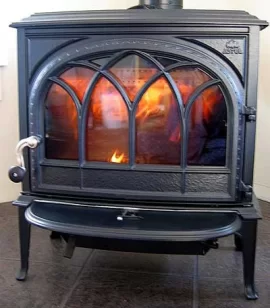

Your stove looks like it's burning fine once the flue heats up. You may notice a nice improvement once winter temperatures set in. With good draft the secondaries will kick in and burn robustly with a 400F stove top. You will find that you need to shut down the air all the way sooner, or the stove will get quite hot. Thicker splits will help extend the burn time. Fully packed with big leaf maple and alder I would get about 4-6 hr burn times from the stove depending on how hard I was pushing it. With hardwood in milder weather (30-45F) the stove would still have good coals for a restart at 8hrs..

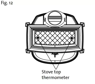

Note that the manual shows thermometer placement at the sides of the stovetop patterned area. Here's a shot of the Castine cruising at 675º stovetop.
