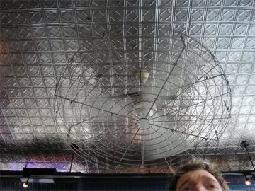

How about adding a huge one with a cage like this. That should break up the air stratification and the cage will stop the blades from slicing anyones head open. As a bonus it looks great!! Go big or dont go at all.

(BTW, for ScottF: if I put something like that in the house my wife would have ME in a cage!)
