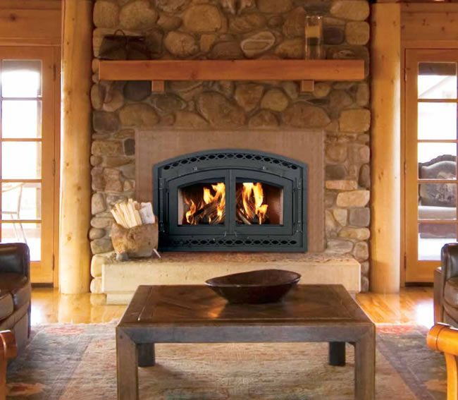

This is the room it is going in: [Hearth.com] Need a large ZC high efficiency fireplace ASAP that has an optional heat distribution system

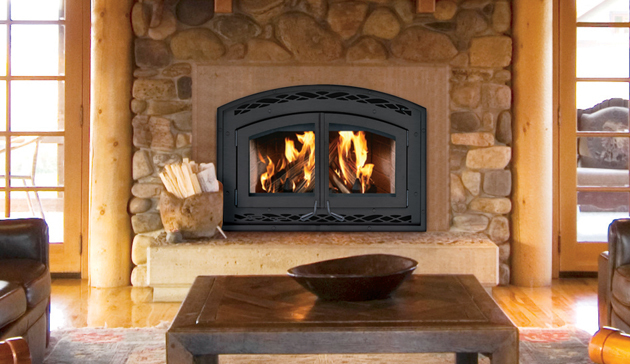

Try to find the Astria Montecito Estate. Same thing.
The Northstar is the brother of the Quad 7100

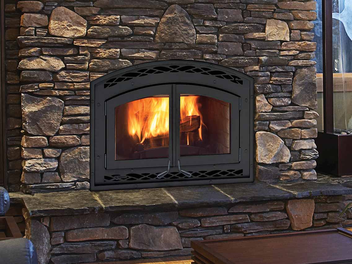

I ended up going with the Northstar. Smaller but that was one of the few available options from the sub-contractor that does the fireplace installs. I would rather them be familiar with an install rather than trying something for the first time. I like the look of the Northstar, but I was also excited for a really big fireplace. Oh well, custom home building has some sacrifices involved in it.
