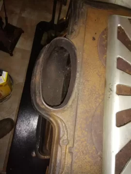

Need a peace to hookup my wood stove any Ideas ?

Need a peace to hookup my wood stove any Ideas ? From left to right measurements is 7 in on outside & 3 1/2 in front to back gets narrower as his arou

Have you tried simply ovalizing a 6” pipe?
To add to that, some 1/4" rope gasket can help seal if the 6" oval isn't perfect
