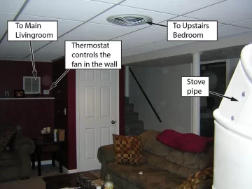

Now that I've remodeled and insulated my basement, I really have a big temp differential. I run that stove on low and my basement stays in the mid 70's while my main floor and upstairs are in the low 60's. I keep the ceiling fans on in the upper levels to draw air up. I have a register in the basement ceiling going to the upstairs. And I have a register in the wall to the main livingroom that has a thermostatically controlled fan. I've had that room up to 85 and the main floor will still be about 65.
I'm thinking about putting a couple more registers in the ceiling, but from what I've read, I'm not sure that is going to help all that much.

Try a small desk fan or tower fan on the top portion of the steps blowing over the couch towards the stove. This should help getting a loop of air flow going displacing the warmer air either up through the vents or up through the doorway at the top of the stairs. I have one at the bottom of my stairs with a direct shot towards the stove and it made a big difference!
Have you tried reversing the direction of the fan so that it sucks air from the living room and blows it into the stove room?
Did you ever consider adding a coil to your stove? Pretty easy from what I have read, then install a piece of baseboard upstairs.......
Try what Begreen suggested and try different combinations with the fans to get a loop going and see what works best.
