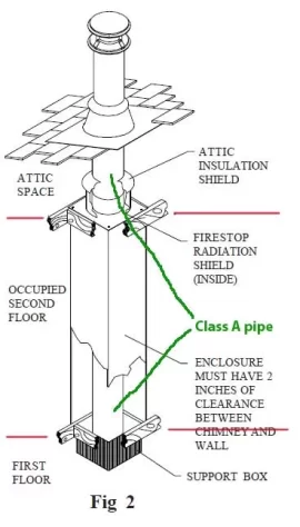

So if I keep the chimney inside I will need to go through the second floor and out the attic. I assume I will need a thimble through the ceiling on the first floor and double wall pipe. I will box the pipe on the second floor and then up through the attic and out the roof. Anything outside will need to be triple wall correct. It will be a straight run but I might need a 45 at the very top so I miss the peak of the roof, will that still work.
Thanks again for all the info this is so helpful. I will defiantly research other stoves and yes i have plenty of clearance for my fisher.
Use the Excel metal roof flashing. It's the best for the job. You will need a regular ceiling support box on the first floor and there should be a firestop at the second floor ceiling. The second story chimney part should be chased. I would use a good double-wall class A chimney pipe, not triple wall. It will have better insulation and 2" less in diameter. That makes it easier to work with and will fit the recommended flashing. DuraTech and Selkirk Ultra-temp or Super-Pro are good chimney pipe. Folks also report liking Olympia Ventis chimney, though I have not used it yet. 45 offsets are not allowed (or made) for chimney pipe. 30 deg. is the maximum. If possible try to avoid this by positioning the stove so that the chimney comes up close, but not right at the ridgeline.
excel flashing
(broken link removed to http://www.icc-rsf.com/main.php?t=chem_produits&i=95&l=en)
