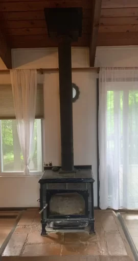

The current oslo has a cat and one that has been problematic. What is your chimney setup like? Smoke leaking from the stove makes me think low draft or lack of adequate makeup air

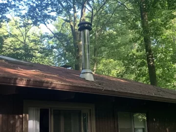

The chimney could do with being replaced and maybe a little higher, but I think it’s the stove itself, maybe a seal because the start up smoke comes from the back top left just a wisp nothing serious

Do you have single or double wall stove pipe? You don’t have to use the blower even if it has one.
I’d be tempted to replace replace single wall with double if I utilizing the tax credit. Here is a link to the Drolet escape 2100. It’s a big stove and with double wall I think it has a 6” rear clearance. Tax credit eligible, big at 3.5 cu ft. It’s not a work of art but it’s price is attractive. (I have the 1800 version as an insert). https://www.drolet.ca/us/en/wood-stoves/db03129/

It’s a double wall pipe but all the dealers we have spoken to have quoted us for full replacement of the chimney because it’s 23 years old
