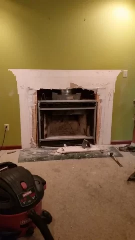

It's been a couple years living with my prefab and I want more heat.
Newbie with Heat N Glo EM42 fireplace - Pictures
I've researched and I've decided not to try an insert into the prefab. I also don't want to turn this into an alcove with a freestanding. So that leaves me with putting a good wood burning fireplace into the prefab spot with some modifications.
I've heard there are some zero clearance good fireplaces. Can you recommend any? Or any other good options. I'm handy. Installed a pellet stove in our last house, remodeled houses, etc.

I'd really like to avoid messing up our existing brick work. Our current opening is 42" wide x 34.5" high. Kind of limits me. Pacific Energy FP 16 or FP25 might work. Any other small, but good, ZC units?

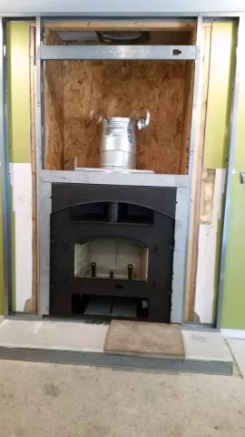

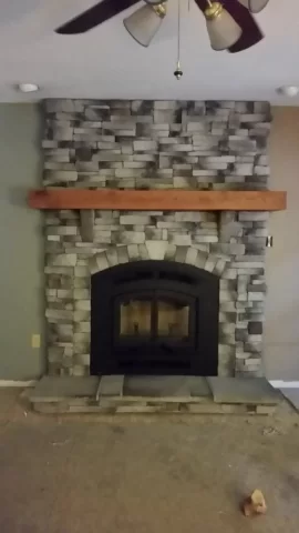

The customer has their tv about 5' from the fireplace in that picture. They LOVE their fireplace and the fan is not an issue.
We really like our Stratford by Osburn, another SBI company. The fan is noticeable but not so loud on low that it's annoying, even on high I don't find it annoying. Our TV is to the right of our fireplace, so the fan noise in the left ear and TV in front. I dont if you can completely remove your current setup without some brick work. As in the picture on your old thread, ZC units have bolted/ welded standoffs to make install more foolproof to clearances.
