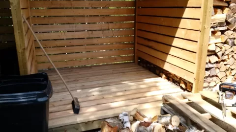

From previous posts I've seen, it seems many if not most folks on here who build sheds exclusively for firewood tend to leave all sides open for max airflow. I don't doubt that it works for them, but for mine, which I just built last summer, I chose to close in three sides, leaving only the leeward, east facing side open. I chose to enclose the 3 sides due to the winter weather that is typical here atop the Blue Ridge in Va., in which we get series of days of dense blustery mist that infiltrates all pores, nooks, crannies, etc. With all 4 sides open, my wood would take on significantly more moisture during these wet sagas than it does with only one side open. Some would argue that this is precisely why all sides should be open, to allow maximum ventilation to dry the wood back out once the wet air moves out. However, in my experience here at least, I'm finding that during winter, if my wood gets more than a certain degree damp it's awfully difficult to get it dry again until the warm days return. (I did also install three hinged "hatches" into the back wall of the shed that I occasionally prop open on sunny breezy winter days, which does help dry away the misty damp.)

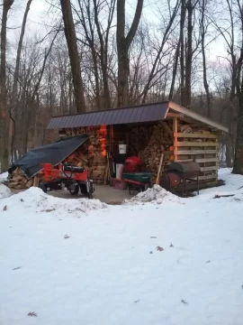

Tarpon washer just covering it until I could stack it but I have 4 sides opened to the air circulation, works well for me. Each side holds about 5 cords

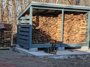

I built my shed 24' x 8 ft and then put in little pony walls every 8 ft to give me 3 stalls - i burn one stall per winter.
We get a lot of harsh north winds up here, and lots of blowing snow in the winter, so I chose to put up boards on 3 sides, leaving the front face totally open. You can see in the one picture there that there are 1" gaps between the side boards, and I also left some space closer to the roof line for air to blow through the shed. In the fall, I hang tarps down over the open face to keep the blowing snow out.
I process my wood and stack it straight in the wood shed. Since I have a 3 year rotation, all the wood gets to sit in a stall for 2 full summers CSS before it goes in my stove. I stack 5 rows deep. I got into some wood this winter from the middle of the stack that was around 18-19%, which I wasn't super happy about, but it still burns. From what I recall, this wood also hadn't been in here the full 2 summers. Also, my shed gets a bit of morning sun but otherwise is in the shade most of the time.
I think it's wise for you to factor in all the unique things about your location to determine how you will build it up. Certainly leaving all 4 sides open gives more air flow, however this may not be great in all locations (like mine with all the snow).

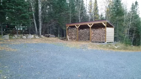

The OP does not say if he lives a in snow zone. That makes a big difference. Blowing snow can really be a problem as it gets up under the roof and takes a long time to dry out during the time of the year you want dry wood. I started out with no sides with overhangs but after a year I covered the wet end (where the prevailing winds are with silver tarp. The back is pushed up against softwoods so there is no need to have it overed. I do a have large X brace to keep the building from racking. The less side is always open. i used to leave the front open but snow getting in was still an issue. I ended up covering it with a tarp from October to when heating system is over. It takes me a couple of minutes to remove the tarp when I load up my bulkhead.
