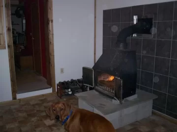

I have a Morso 1125 stove (as I recall). I love it so far, and 99.9% of the time it works great. The only complaint I have is when I load it (3 times a day), when I open the doors smoke comes back into the house. When the doors are shut it runs fine with no smoke. I have triple wall chimney pipe. I THINK the problem is the outdoor part of my chimney is only 6 feet tall. I was thinking that if I snapped on another 3 foot section it would help draw the smoke out better. Opinions? Here's a pic of the indoor part of my install. Pretty straightforward, exits out the top, and just 2 45 elbows with a short straight section. If it helps, when I get home tonight I can snap a picture of the outdoor part too.

You also have a short vertical coming out of the stove, dropping the stove down and adding more vertical rise before the exiting the interior will improve things as well.

Why did you not just go straight up through the ceiling? I see no reason for a through-the-wall.

Going through the ceiling was impossible for a few reasons, I don't see a reason to get into it, I was just looking for solutions to fix my current problem, not defend the install. Lots of people go through the wall and don't have draft problems.

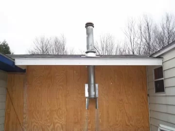

Here's the chimney.
Another thing you may try is on the outside where the indoor pipe meets the outside is to change it from a T connector to a 45 elbow, this way the smoke makes a curve up instead of meeting a dead end and having to splitting up and down. I'm sure the T provides some air flow disturbance and turbulence. I know that in dust collector system for wood working we try to avoid any T's and try to make all turns as gradual as possible in order to reduce the amount of static pressure loss. Granted this may improve your draft but cleaning...well :-S

Put 6 more feet on and draft problem went away completely. Thanks for your help smartass.
