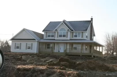

here's a pic of the house. The roof over deck makes things harder too.

Hello New_Burner...I would install a 2 by 4 cleat a foot in from the porch roof edge...and seal it with roofing cement so that it wouldn't leak...then use an extension ladder to clean the chimney. Franklin

It doesn't look like the porch roof sticks out beyond the plane of the the main roof but it doesn't look like a 40 foot ladder would reach at that angle. A 40 footer might reach from the gable end where you can set it at a much steeper angle. Use a ladder standoff that's wide enough to catch the sides of the chimney. Once you get up there, tie a rope around the chimney too.

If you park a pickup on that side and set the ladder in the bed of it, it will give you a few extra feet of height and give you something solid to tie off the ladder base to.
It also looks like you could find yourself a comfortable spot between the chimney and the peak that you can wedge yourself into. Consider mounting a permanent Roof Anchor at the ridge. Google Permanent Roof Anchor.

Been a while, but from roofing for a living for many years, that looks steeper than a 9/12.
I used to be able to eye a roof and dam near guess the pitch.
The garage is probably 9/12 but the house looks to be 12/12.

i agree with the sweep idea.. That is one hell of a roof at one hell of a hight. I would get a pro to do it forever. The $200 /year would be better then one ride to the hospital or morgue. by the looks of that house, a sweep every 4 or 5 cords should not put you in bankruptcy court.
