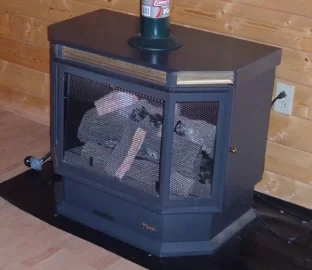

When I bought my cabin in WV, this gas log stove was included. According to the owner's manual, it was purchased in June, 1995. Not sure if it is 24k or 30k BTU, but uses LP (propane). It has a built-in blower with a thermostat, so that when connected to 120vac, it turns on and off automatically. I've used the stove several times over the last several years just to initially warm the cold cabin, then let the wood stove maintain the temps, once the cabin has gotten to a comfortable temp. The looks good and works very well.
Last time I was there, I tried to light it. I held the control knob pushed in until the gas arrived at the pilot, then used the piezo igniter to light the pilot. I held the knob in for about a minute, then turned the knob to the operating position. Instead of lighting the burner tubes as usual, the pilot flame went out. From then on, after many attempts, I could never get gas to the pilot (no gas smell, no hissing sound). I checked the bottle and there was plenty of gas in it and the valve was open. I tried disconnecting and reconnecting the gas supply hose and the blower cord. For several attempts, I left the stove for several hours, then retried. No gas to the pilot.

Sorry, should have mentioned it's a vent-free unit. (And the photo was taken 5 years ago...the stove isn't sitting on plastic with a bottle of gas on top!)
