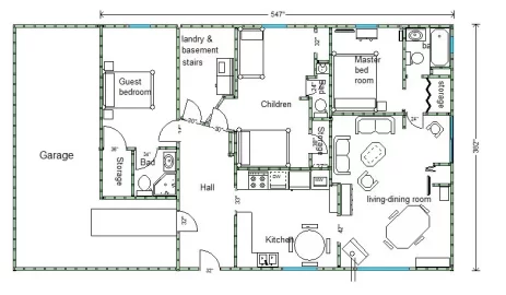

at the moment we install a Drolet Eco‑45 in the Living room.
It is nice to heath the living room, Kitchen and the area from the master bedroom.
a isolated pipe runs from the ceiling over the stove in the loft with a 80cbf van to the Children room (on +5C and more it holds the temp in the room but not more main heat by central oil airforce)

now we plan to buy a 2. pellet stove to heat the rest from the house.
but what will the best place to heath the rest area??
any idea for us ??

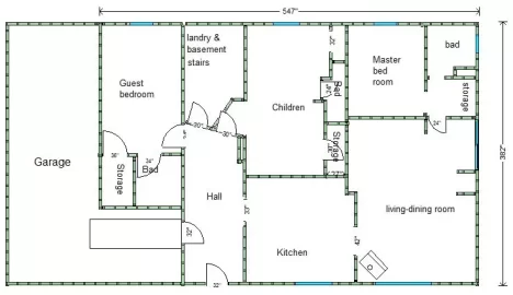

Maybe just a bigger stove? I don't see a natural place for a second stove, unless you can squeeze a small one in the hallway. But I think if you just went with a higher btu stove and placed it in the lower right corner of the living/dining area would heat the space better.
Another option is to get a stove that has venting/ducting capabilities, and put it in the garage. Run the vents into the guest bed, hall, and children's room.
the stove in the living room runns on 1or2 but if i go hogher there it's overheat then room :(
maybe a 2. stove in the landry with pipes to the 3 rooms will help?

I still think the garage would be the best place for a large stove with ducting to the other rooms.

and a stove in the garage need i higher point or a wall to the car area :(

ups sorry i forget the guestroom with the bad is NOT hook on with the furnace air :( the preown built this rooms in the garage and heat it with e-baseboards :(
that's why I'm thinking about the boiler kit and hot water baseboard heather for this
