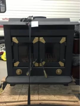

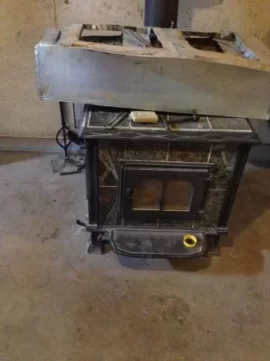

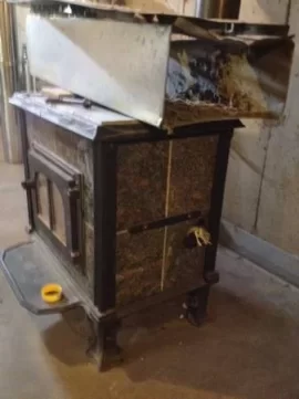

So I found a couple that maybe someone here can help me identify. Both intrigue me as far as looks particularly the second one. Neither is identified in the ad and I haven't had a response yet so I'm just being impatient.
#1 [Hearth.com] Need help identifying a VC stove [Hearth.com] Need help identifying a VC stove [Hearth.com] Need help identifying a VC stove
Any thoughts? I have become slightly obsessed with wood stoves now even though I've been burning wood for most of my 50 years.

2nd stove looks like it may be a Hearthstone H2
Search on Hearthstone II in title only. There are many threads on this stove. Also, in the classics forum there is a thread on a complete rebuild by Kevlar_vw .
Thanks. I just got an email back and the soapstone sold. $400 with a lot of stainless triple wall. Seemed like a pretty good deal. The other one has no tags left as the owner had it blasted and painted. He didn't really care to help as far as brand or model so since I won't deal with people like that it's on to the next. I found a pleasant hearth 2,200 at Lowe's down in Illinois new at $479. It doesn't look like they will ship it to a store nearer me though. I'm checking into it further. It has some really good reviews and then some not. Mostly seems like people who have problems are suffering from poor draft. They don't say, but maybe they are venting through a wall and not getting the stack high enough. I'll be going straight up 8' from the peak and extending above the peak 2'. The cabin is on high bank lake frontage and should provide good air movement as far as draft is concerned. It sounds like I may need to do a few small mods to get the stove to give me the 6-7 hrs of burn time I'm after. I believe they come with a 5 year warranty also. Since I think the stove looks decent and should be dependable since no cats etc. I'm leaning this way for the moment. I'll be back often as there is an addition planned for the cabin and I'll need another stove for that. Thanks again guys. It's nice coming to a site where people are willing to share there knowledge.
