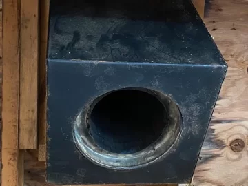

Good Day, I am trying to connect to this chimney pipe that was installed 15-20 years ago in my shop with DVL. It is 6 inch stainless with thread twist type connectors for the stove pipe to attach to. DVL does not have threads that I am aware of. Can I install DVL to this chimney? I had my new GM60 connected to the same chimney type with DVL by an installer a few weeks ago. Unfortunately I was not there to see how he did it. Any thoughts?
Thanks, Dave
[Hearth.com] Need help identifying this chimney manaufactor
The DVL adapter twists in a quarter turn to lock it in place. That goes between the support and the stove pipe.
There might be some old stickers on the class A portion of the pipe, I'm pretty sure that as far as class A pipe, you need to use the same components for everything to work, if its dura vent class a then the support box should also be dura vent. I have a dura vent system and tied my dvl with the black adapter that has a screw flange that gets screwed to the bottom outside of the big, but there's also a stainless steel inner ring that would work to.
Thanks guys...I think I have it. Here is what I am looking at.

If possible, it should be verified that this is a Duravent system. If that is hard, then maybe just get the adapter first.

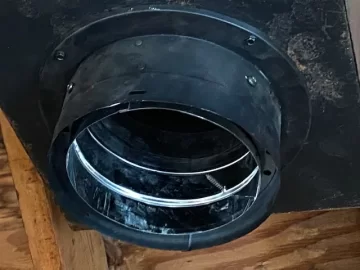

OK, received my M&G Duravent chimney adapter. I have installed it and am ready to purchase more pipe. Do I need all M&G Duravent? Will Simpson Duravent work? Some are listed with neither M&G or Simpson, just Duravent. Combination of both? I have searched, and am finding different opinions. I have all the "Duravent" part numbers (listed above from Duravents web), just unsure of the manufacturer dependencies.
+ I just called Woodland direct and they are saying all Duravent DVL is interchangeable......help?
Thanks!
Thanks!
That's correct. As long as it is Duravent DVL it is interchangeable.
Here is the photo of the M&G Duravent chimney adapter installed. I may take some Rutland furnace cement to the inner ss pipe joints, just to close any gaps. Look OK for more DVL Duravent?
