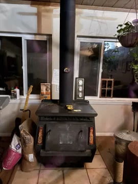

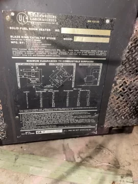

I am looking for some general guidance in identifying a vintage BlazeKing model in our house, believed to be from around the 80's. The wooden door handles on the door to the fireplace broke and need to be replaced as soon as possible. The backside plate (image attached) says Blaze King Catalyst Stove and under model says 'KFJ'. Attached is an image of the stove as well.
Any input or help in identifying the model to find the correct wood handle replacement (does not have to be an exact part or replica of the handles as long as dimensionally it fits on the metal pegs) would be greatly appreciate as I have to have them replaced ASAP.

Here are the photos of the front of the stove with the door that needs replacement wood handles as well as the plaque on the back for identification.

Wonder if some generic spring handles could be put on there.
KEJ, not a KF (they were non cats). The part number for obsolete handles is #0113.
Lots of dealers would order them by the dozens. Try calling dealers in CA, all posted at www.blazeking.com
