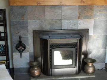

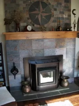

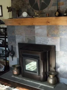

We went with a Thelin Providence this year (no expert). So far love it. Keeping the house nice and toasty 72 plus. I do clean every other day but don't know any better. We didn't have room for a FS. House is approx. 1200 sf. Cape. Photos of our stove. [Hearth.com] Need help in deciding which Pellet Insert to get in the new house we just bought [Hearth.com] Need help in deciding which Pellet Insert to get in the new house we just bought [Hearth.com] Need help in deciding which Pellet Insert to get in the new house we just bought
Hey John,
I am putting the pellet stove in a cape as well, how well (or not so well) does the heat reach your upstairs bedrooms? Just curious...

As heat is known to rise , upstairs is as warm as down with no fans needed ( doors up there left open). It is 6 degrees outside and house is 71 We run mostly on low and bump to med. a few time just to feel a blast of heat. High for a laugh. The unit has battery backup ( still need to pick one up). No oak was installed and thinking of putting one in for next season. All in all we are very happy with the unit it is doing what we had hoped it would. We do run the furnace on occasion just to exercise it and to throw some heat in the basement as there is no insulation down there ( next project among many). We started with just over 3/4 tank of oil and have just under 3/4 tank. Very happy with that.

Thank you I found the compass I wanted on line, sized it to what I liked, made a template and hand picked and cut the slate to order. Mantle I made from pine and built it to slide over the old like a sock. I should say I have been a Tile Setter for over 30 years. I do hire out and travel and would love to transform all the fireplaces out there...or most.....LOL!
P.S. Compass points are also done N, S , E , W...cant see them in the photo.

Thanks for the info, clearly a professional job!

Enjoy and good luck..they are great! Need any tile advice please ask...can only make it prettier :)
Actually John, I am thinking about going over all of the brick (face and base) with slate, is it hard to do? I've laid tile in my kitchen and bathroom, but have never done any work with slate or going stone over stone? I don't want anything super fancy just something a little more updated (plus, I don't really like brick)
