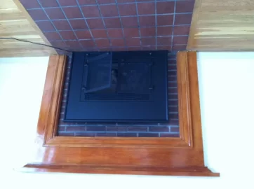

Great, thanks for all of the input!! Here is a picture of the area/hearth with the old propane insert in it. The hearth extends 38" from the face of the brick. I am definitely leaning towards an insert vs a hearth stove as the room is not that big and something that takes up less real estate the better.
Man, they used that same tile up in MA? I have the same tile on mine built in 55. Depending on the insert you might have clearance issues with that wood mantle.
That looks like a perfect setup for a small rear vent stove like the woodstock keystone if you are not trying to heat a lot of space, but you will need to check that wood mantle with it as well.
