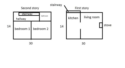

im going to try and make up a drawing of my house it's half a double. im worrying about the heat going to the upstairs

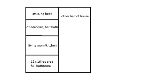

What is 1/2 a double?
i wanted to put it in my basement, it's roughly 300 square foot.. but i figured to put it in my basement and just use electric baseboard for the basment. my house is 4 stories, starting with a finished concrete basement, then the upstairs has 2 rooms a living room and kitchen, then the 3rd floor has 2 bed rooms and a half bath, just was worried the heat wouldnt travel 3 stories. my house is literally 2 rooms stacked on top of eachother lol..i live in pa as well

not the greatest display but hopefully you can see what i mean now by half a double
Got it. If you decide to join us pellet burners be sure to check your local codes on installing a pellet stove in two family dwellings. You may required to pull a permit and have it installed by a licensed contractor.

im using a site to have the exact measurments of my home layout, ill post them in here as i feel everyone is confused on my 1,800 built row home.

haha i had my mind set on the 68 until i seen it in person and felt the heat coming off of it set at 75. the total square foot where it will be installed at is 420 square foot. it is a 13.3 foot long by 14.3 wide living room with a partitioned wall separating the living room from the kitchen, the kitchen is 13.4 long by 11.3 wide with a staircase going to the upstairs bedrooms which is 2.7. the bedrooms are both 8.8 wide by 13.4 long with a hallway that is 2.4 wide by 18 long going into a 5.4 wide by 9 foot half bathroom. hope this helps explain how its set up..

I agree that the size of the stove won't be the issue. A P43, will heat that space. You just need to get the air moving. A bigger stove would probably just make the first floor hotter.
You'd have to have SERIOUS heat loss issues for a P43 to not heat that space, IMO. A 61 would be overkill, and forget the 68.
I too am confused as to your house's layout, specifically, how many levels you have. 2 story house, correct? Basement, first floor and second floor? If I were you, I'd skip the basement install and install it on your main living floor, unless you spend a lot of time in the basement because that's your family room or something. If that's the case, any pellet stove will likely cause issues with trying to control the temps on the second floor. You may in fact need the HP of a 61 to generate enough output to reach the second floor, but in the process, your basement will be unbearably hot.
If you put it in your basement, why would you use electric heat down there?

It's tricky to tell if the heat will get up that stairway with any efficiency. the way ours is setup i have a ceiling fan pushing down on the stairwell so all the heat doesn't end up up stairs. Yours has to go around corners first. . Some heat will naturally rise though.
