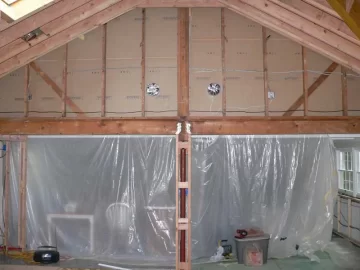

Hi everybody. I need some help choosing the right stove for my home. I have a 1200 sq. ft. area downstairs where the stove will be. 600 sq. ft. of that has an average of 10.5 ft. ceilings, the other 600 has 7.5ft. I have two 200 cfm room to room fans installed up high on the wall to force the heat into the upstairs area, which is about another 600 sq. ft. with 9ft. ceilings.
I have been to several dealers and am getting mixed advice about the size of the stove I need. I really like the Lopi Leyden, but have been told by one dealer that the 2,000 sq. ft. heating capacity will be way too much. They reccomend no more than a 1600 sq. ft. capacity stove. ie: the VC Resolute.
The main living area is downstairs in the room where the stove will be. I don't want to create a sweatbox, yet I don't want to short myself either. I attached a picture taken from against the wall at the exact spot where the stove will be. You can see how the 600 sq. ft. room is very open to the other 600 sq. ft. area downstairs (separated by plastic right now). You can also see the fans which will kick the air upstairs.
I have done lots of planning for this, and I don't want to screw up now! Please help!

The upstairs area is about 600 Sq. ft., and besides the fans, there is an open stairwell leading up there. I certainly don't want to have to choke down the stove so much that I get creasote, and of course I would like to be able to load the thing up.
Pyro, is what your saying is that if a manufacturer claims the stove output is say, 70,000 BTUs, I should expect only 1/4 to 1/3 of that? I used the BTU calculator on this site, and it calculated I need 29,156 BTUs JUST FOR THE 600 sq. ft. rm the stove is in. Also, I calculated that room is 6300 cubic ft. With two 200 cfm fans, that means I am moving 400 cubic feet per minute. According to that, it can exchange the air in that room every 16 minutes. I am not sure how much this really affects the size stove I can have, but I'm putting it out there for you guys. What do you think?

Watch out for those fans. 400cfm is alot of air movement and could create negative pressure in your basement and cause back puffing of the stove. May be better to turn the fans the other way and blow the cold air down towards the stove. You will have to experiment both ways.

Here's the setup. Personally I would have just put windows in the upper section for a passive installation. No need for fans there. Heat will accumulate higher up. You will want a ceiling fan in this room with the high ceiling.
My opinion is that you will be fine with a medium sized stove in this setup. You can always just add less wood when the temps are moderate. Have you looked at the Woodstock stoves?
