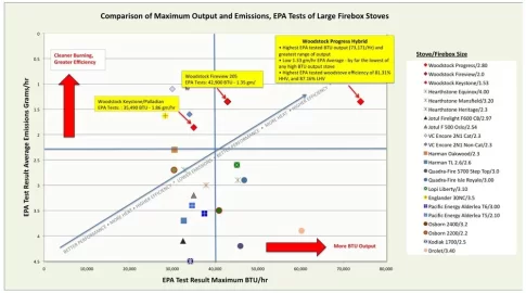

Thanks for all of the replies so far. I went to the Woodstock site and looked at their stoves and their Progressive Hybrid looks very nice. There is a chart on their site that compares max output and emissions of large stoves, and of course theirs are on top, with the Lopi Liberty and Quadrafire Royale a little below. Surprisingly, it shows the max output of the Jotul Oslo higher than the Firelight. But, I tend to take any of these types of charts with a grain of salt. Still, it's interesting to me.
