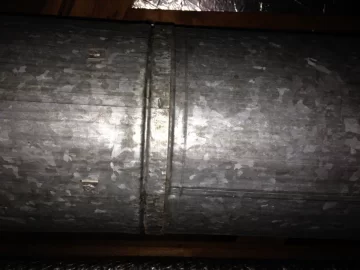

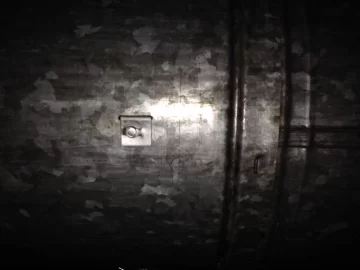

Have just purchased this home built around 1990 and I want to build a real wood fire in the fireplace but I'm unsure as to what type of pipe the chimney has , It appears to be 12" outer diameter and looks galvonized ? I cannot find any labels or brand name anywhere on piping.

Can't tell from that picture. A picture of the fireplace might help for an ID. It could be air-cooled fireplace pipe. Look for a label around the opening of the fireplace that identifies it. Is there any gas piping or are there gas logs in it currently?

It could be fine for wood burning. What you'll want to do is get it cleaned and inspected by a certified chimney sweep. If it gets a clean bill of health then you will be good to go. The only obstacle then could be finding dry wood. You are going to have much greater success burning and keeping a clean chimney with well seasoned wood.
Here is where to find a certified sweep in your area. Type in your zip code.
www.csia.org and www.ncsg.org

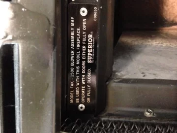

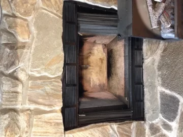

Here are a few pics of brand of fireplace and inside and outside pic of it

This is a standard Superior fireplace. FAK-1500 on the label is for the fan kit. There should be another label lower riveted along the opening edge of the fireplace. The model will be something like BC-36.

See a 38B on it
