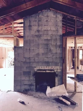

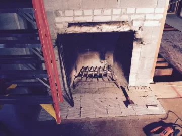

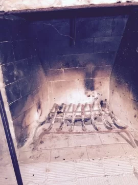

Hello, I have been reading up on this site for the past few months. Now that I have joined was hoping to look for a little help. I am in the middle of a full renovation of my house. Everything is basically gutted, including the old brick off the fireplace. We are switching it to a veneer all the way to the ceiling. I have attached some pictures and I am trying to figure out if it is big enough to put a insert in. To me it seems shallow(even when the full brick was on it). I will put up measurements soon as I get back over there, but for now here is some pictures. Thanks for any help!

Welcome. That's a big project. We'll need the dimensions to make suggestions. Not sure if an insert will fit, but it does look tall enough that a freestanding stove might work out on the hearth in front of the fireplace. You might get more heat that way. Or you might build out the front of the fireplace with brick or stone to add depth for an insert.

Front height is 33 1/2". Front width is 35", back width is 21", and depth is 17" with no brick attached to the face.
Will you be building out the front with stone, brick, or tile or anything that will increase the depth of the fireplace? What kind of look is she expecting? Will this be primarily for a big fire view or good heating too? Right now I'm thinking a Hearthstone Clydesdale.

Also yes we are adding stone again, before we ripped it off the depth 21 1/2".

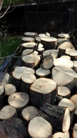

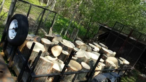

Oh and I got a few trailer loads of I believe sugar maple from a neighbor that had his tree cut down by the power company.
Here's a picture of one of the loads.

Take out all of the firebricks, remove the smoke shelf and square it all up. Cover the inside with stone and set the stove back in there, it'll be inserted.
Knocking out those top bricks and raising the lintel would give it a nice alcove effect too.
I know you have your hands full but you are going to need cords of that wood split, stacked and drying a couple years in advance. The difference between burning semi-seasoned wood and good dry wood is quite noticeable and desirable.
Any idea how long standing dead ash takes? I have a few hundred dead ash at my property.
Ash has already a low moisture content when green and often dries sufficiently over one summer when split and stacked in a sunny and windy location. Dead trees can vary quite a bit in their moisture content. The top is often drier than the lower part of the trunk. When the bark is off that helps, too. I would keep a moisture meter handy when splitting to check a split from each round you are doing and then sort them accordingly.
Ash is excellent firewood and dries quickly. Standing dead is not a guarantee of dryness, but it's a good start. Rounds from the trunk bottom may still retain moisture. Regularly test an occasional split for moisture on the fresh face of the wood as you are splitting. If 20% or lower you are good to go. 20-23% will dry pretty quickly if you bring it inside.

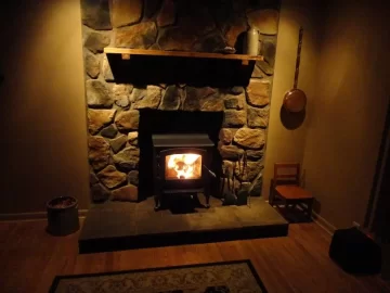

My wife loves the way our stove looks mounted in the fireplace, but then, she had to look at an insert in there for 7 years.
