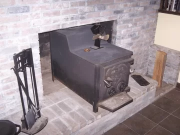

Still quite the newbie and learning how to operate the beast in the basement. Our sweep told me to burn between 550-650 according to stove top thermometer..
What happens if we burn outside that range? It's not easy to keep it in that 100 degree range for long -- maybe 2 hours max, then it starts dropping. If I step outside to look at the chimney, anything over 400 is smokeless, so I am assuming a clean burn, but perhaps I am wrong. Why is the range 550-650 so important, and am I creating a creosote disaster if I burn below that temp?
Here is the beast:

Once the wood gases are burned off you are burning charcoal. The risk of creosote build up is minimal after that point. Temps will gradually taper downward until either the stove gets reloaded or the fire goes out.
Without too much going into detail, I would burn smaller hotter fires when home, leave the lower fires for overnight and check the chimney once a month or any time you suspect there may be stuff in there.

Thanks for the response. That helps. But to make sure I understand, burning at 400 on the way down is OK, but I should not attempt to hold a steady burn at 400 on the way up? In other words, our target range truly is 550-650?
Sorry to be so dense...the truth is, I am terrified of this dragon and doing something wrong. It's so old and I cannot find any information on the manufacturer on line, so there's no manual to tell me what to do. A neighbor told me the stove looks like a Fisher knock-off, and it has the same dimensions as a Papa Bear. I've read that manual posted here on Hearth.com, which states to burn between 400-450. Our sweep is coming back December 8, earliest he can get here, and I'm trying to not burn the house down before he arrives.

Thanks for the reply. What is an appropriate "hot" fire for this stove? Is that in the 550-650 range?
I try to answer in a way that reflects what I would do if it was me burning in my own home. Assuming your chimney was lined, I would try to keep the stove in the 5-600 range and try not to let it spend too much time over 700. So if I was home, Id open the air up a little and throw one or two logs in every couple of hours. For overnights I would just not have the goal of choking it down for an overnight burn, because Ive seen a handful of small fires take a "clean" chimney and give it enough creosote for a chimney fire. I would just load it half full at night , set the air for a medium burn and let the stove run out when it did.

Thank you! Very helpful. I work from home and my office is 10 feet from the stove, so I babysit it and am constantly checking the stove top temp to keep it in that range. I just wasn't sure if that was the correct range based on other things I have heard and read. With no manual for this dragon, and being new to wood stoves, I'm really afraid of doing something wrong. For overnights, we will only need about 6 hours because of our work schedules. We've been experimenting with different overnight logs, and at least we'll have hot coals to restart in the AM. For ridiculously cold nights, hubby will be getting up to feed it.
Right now we're trying to figure out what our heating needs are as we've not yet spent a winter in this house. We will be replacing this dragon in the basement and adding a wood stove upstairs as well, but we first want to see how the heat travels and how the real winter temps affect the different rooms, etc. So realistically, we just need to get through one season and then we will have a better idea of our heating needs (the house has passive solar as well, and we are going full solar, with the panels on the roof of the house, which will affect house temps we're told).

In our situation, it is working quite well. There is a noticeable difference without the Eco-fan; the heat seems to linger in the room with the stove and does not move as well without the fan. Our stove heats 2300 sq. ft. from the basement, with the bedrooms 50 feet away and up a flight of open stairs. The heat, therefore, has to travel 25 feet across the lower level, up a flight of open switch back stairs, then down a long hallway to the bedrooms. The fan on top of the stove really gets the air movement going.
