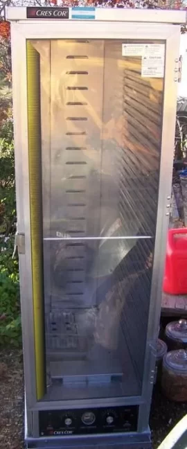

I stopped by a local Government auction and bought this large aluminum proofing oven. It runs on 120v, has electric heat to about 180 degrees and a separate heat coil for humidity. The electrical section is built to be removable so the box can be steam cleaned.
I really have no clue about larger smokers so any input would be appreciated. I plan to add an outside skin of aluminum flashing and insulation as well as remove the window and replace it with an insulated panel.
I have an old fisher mama bear I could use for the burner. Is that going to be too large?
Should I leave the electrical parts in the box and use it as back up heat (or humidity) in case the smoke can't maintain the box temperature?
I was thinking about putting the smoke intake and output in the bottom half of the box, then a stack far enough above the box to create a draft. That way, I can block off the top half of the box to smoke a smaller load. Any guesses on if that will work?
Any other ideas?

I just looked it up that Cres-Cor goes for $1900 new. Hope you got a good deal.
They had 2 at this auction. I got mine for $55 and stopped bidding on the second at $75. In retrospect, I should have gone higher.
BTW, I also scored 2 LCD projectors for $20. One had 4 spare bulbs and they go for about $300 each. It's amazing the things these school districts throw away (errrr...auction).

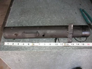

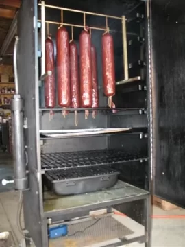

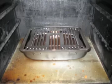

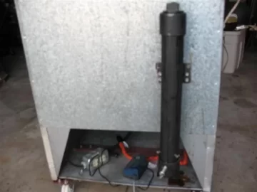

I made the smoke generator with a 16" long piece of 2" black pipe. The ash screen is 1 1/2" from the bottom and a 3/8" pipe outlet 6" up from the screen. I reamed out the threads of pipe couplings to close the ends so they would slide on. For the ash screen I used a hole saw to cut a circle out of some perforated metal I had. Than I put 3 self tapping screw into the pipe and laid the screen on them.
The next one I build will be with 2" fence post pipe and caps, although I don"t know what effect the galvanize will have.
The fish tank pump supplies just enough air to keep the wood pellets smoldering, to much air and they flame up.
The first smoke generator I tried was a Smoke Pistol brand but it only accepted special cartridges and the smoke port was near the bottom where it clogged quickly.
For heat I picked up an electric grill at Wall-mart on clearance .
It burns from the bottom up.
