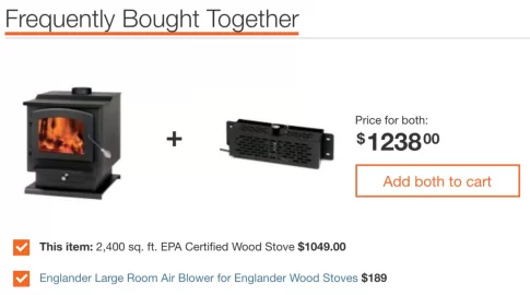

It's new. I think they will hear from owners that a blower is desired for some installations. Like the side shields, it appears to be an option. At least they show one on the Home Depot website.
