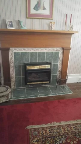

I have an insert but it extends out from the face of the fireplace but it was all we could find years ago. I am looking to replace it with a true insert however the opening is now hidden but I remember it was ridiculously small. Any idea where I would find the smallest one available. I am thinking it was about 15" but could be off on that a bit. Thank you

We'd just be guessing without dimensions. Can you post a picture of the existing insert and fireplace?

Yes it is a gas insert but it overlaps the fireplace and "sticks out" if you will, instead of it being flush with the face or even with the tile around it. I'm sorry if I am not explaining myself very well.

I'm going for a flat front like this one in our den.
This is an insert I have in my den and its more the look I am going for on a really small scale. I think the opening is probably maybe 16H x 20W if that.
That one in the den doesn't look like an insert at all it looks like a prefab fireplace. An insert should never be tiled in. Is the one you want to replace in a full masonry fireplace?
Without knowing the actual fireplace opening size, it's hard to say what will fit. They may have built up the tile to fit the current insert. The Enviro Q1 is an example of a small, flush, gas insert. I'd also look at the Valor Portrait. It's more fitting for an 1836 house.

Thank you very much for your response. That is an excellent starting point and that picture looks exactly what we want. We will know more once we demo the old one.
