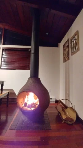

Hello,
I'm new to wood burning stove/fireplace but have read a lot about it. I could use some advice about this fireplace in my rental home. From what I've read, this install doesnt look right. My concern arose after my 3rd fire, I noticed the drywall and the hardwood floors got VERY hot. I of course cleaned the stack and everything before ever lighting it but would like it if someone could tell me what is missing in this setup. Its just a stack to the ceiling and the flue, nothing else. The tiles under it aren't even glued down or anything, the hardwood floor was cut out in a shotty fashion and the heavy tiles just placed in the opening. It doesnt seem safe at all. I'm guessing I should have a protector of sorts on the walls and something bigger or wider on the floor. My house is ALL wood so yeah, I'm pretty concerned lol.
Any advice would be most appreciated!
Thanks!

It could possibly use some more floor protection, but it looks far enough from the walls. It should be 36” from the wall, unless there is a tag or identification on it somewhere that says differently.
If it's a uncertified appliance is there a requirement for more than ember protection underneath?
If uncertified, yes there are NFPA 211 guidelines. The hearth does appear to be inadequate, but how much so is unknown. For sure loose tiles are not enough for even basic ember protection. Not sure who made this stove. At first I thought Meridian, but this looks different.

I guess I'm just not used to the hot hardwood floors and hot drywall, I read the heat is normal but with the entire house being all wood, it's a little scary lol.
So webby3650, are you saying if the 36" clearance is correct then the hot walls shouldnt be a problem?
I think I would feel more comfortable putting something on the walls and correcting the tiles.
Thanks so much!
Hot walls and floors is subjective. Can you hold your hand on the wall when it's hot? If so, for how long?
Yes, probably for 2-3 seconds. This is the first time I've noticed it get that hot probably because this is the longest I've had it burning, about 8 hours. Is there a limit to how long you should keep a fire going in one of these? So as not to overheat it?
The heaters in the home are baseboards and they dont put out enough heat to warm the house when it's 20-30 degrees outside so I was hoping to use the fireplace for most of the heat, try to save some money.
If you turn your kitchen faucet on hot only, how long can you hold your hand in the hot water? Typically, not long. Have you ever been concerned your water lines would catch the house on fire?
Get an IR thermometer and take some temps .
Do get an IR thermometer and take some temp readings. In Canada uncertified stove clearance is 48"s. But everyone knows homes are more combustible north of the border. It used to be 36"s but was changed to 48"s.
Report back with some temp readings
In Canada it would need a floor pad extending 18"s in front and 8"s on all other sides and be continuous and non combustible. And if the floor it's on is combustible for radiant heat protection it would need two courses of hollow 3.5" brick.
2-3 seconds means it's probably under 130F. That's within the safe range for drywall walls.
That sounds good for the walls but what about the floor? I've never seen something like this before? If it's truly uncertified I'd be concerned how it sits directly on the floor if it's combustible underneath? But is it not a concern with these?
Yes, as noted above, the hearth is inadequate. How inadequate is unknown without documentation. Personally I'd err on the side of caution and have at least a type 2 pad under the fireplace and it should extend 16-18" in front of the fireplace door.

That's a sweet stove. And, if you ever decide it's not for you, you can just make a giant batch of guacamole out of it.
Reactions: Squisher
